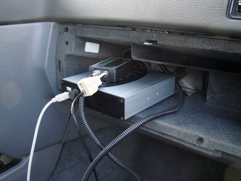

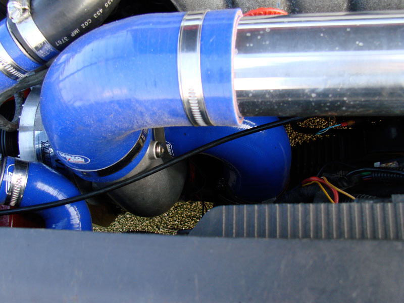

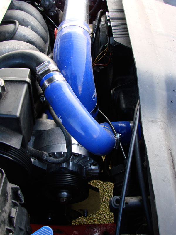

Johann Posted April 10, 2008 Author Report Share Posted April 10, 2008 As it currently is,Linkplus ECU and Zeitronix Wideband in the dash,SC drive,Intake "down under", Quote Link to comment Share on other sites More sharing options...

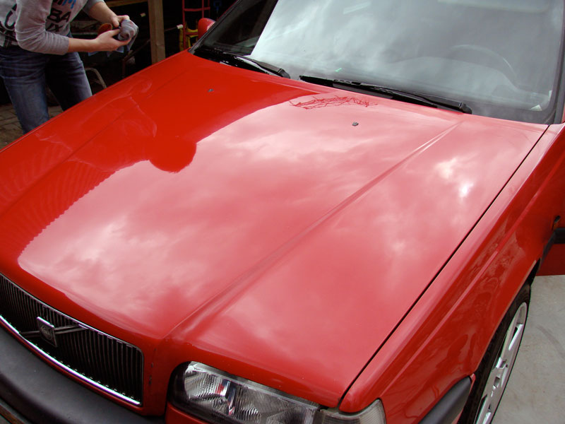

Johann Posted April 12, 2008 Author Report Share Posted April 12, 2008 The hood has been "Raytouched"..Not bad for dead paint. 1 Quote Link to comment Share on other sites More sharing options...
