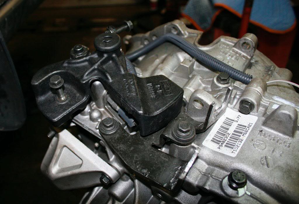

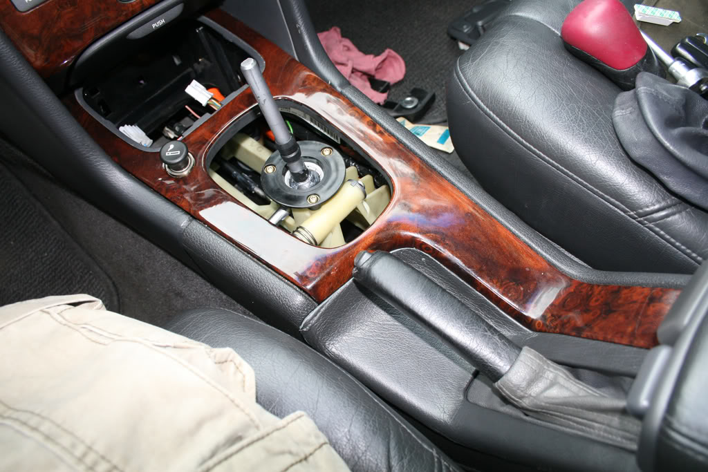

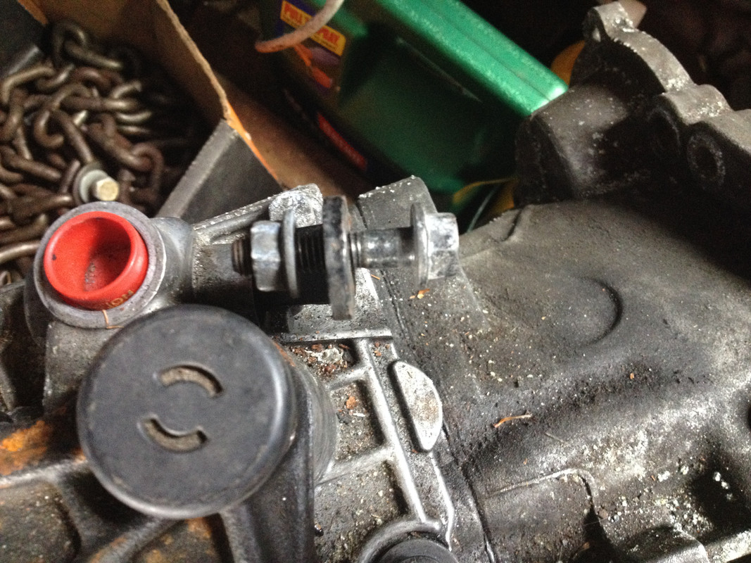

lookforjoe Posted February 26, 2008 Author Report Posted February 26, 2008 Here's some pics of the job... out with the old... in with the new... Pedals & master modified shifter cable bracket forks... ball studs removed & replaced with bolts - I'll be using a cut down shouldered bolt for the final setup - just to make sure the inner wall isn't chewed up by the threads over time... Trans & clutch slave/throwout bearing ready to go in... Angle drive resealed... S60R dual mass flywheel, new Pressure plate & disc... new rear main seal (only 30K on the original clutch that came with the flywheel, but the previous owner clearly had poor clutch control skills...) Quote

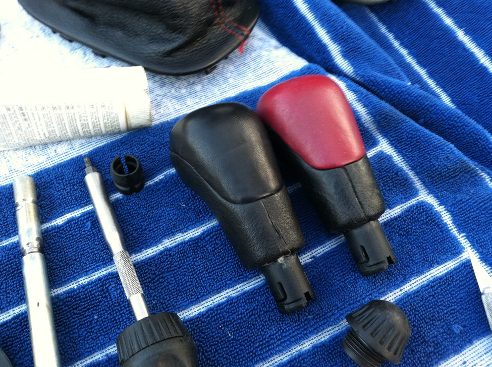

lookforjoe Posted February 26, 2008 Author Report Posted February 26, 2008 Forgot to add the shift knob mod - I checked @ the dealer, and new knobs for the '00 in wood or leather run 87 bucks - the '04 versions run 120... So, I covered the existing with some red leather... heated, stretched & bonded in place... trimmed excess & tucked back into body . all set to go... back in the car... color cast is off due to flash.... Quote
