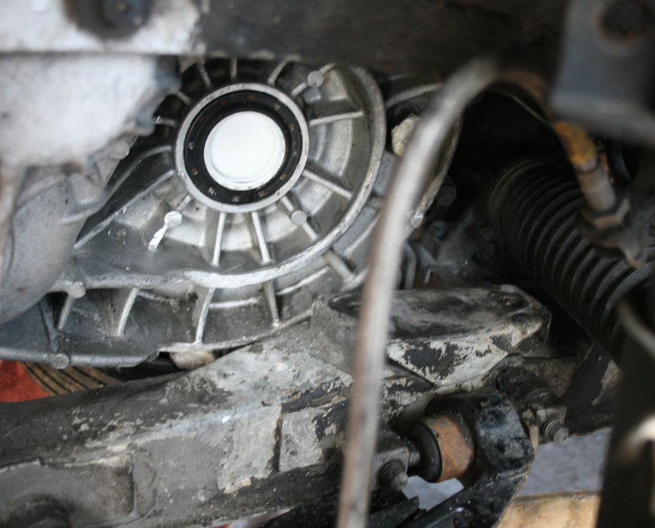

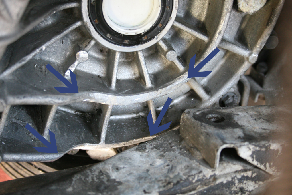

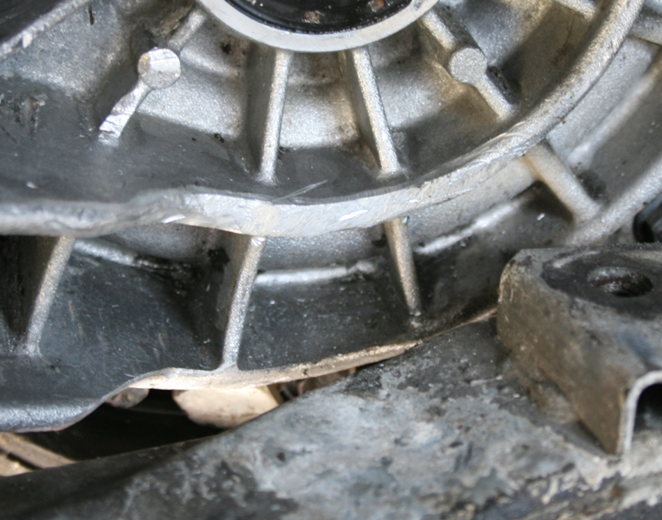

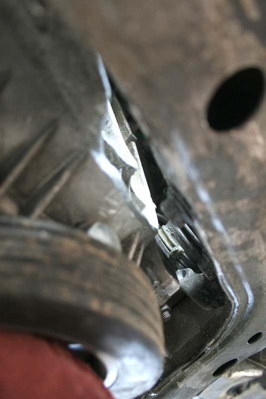

lookforjoe Posted March 21, 2010 Author Report Posted March 21, 2010 Finally got around to modifying the trans case webbing on the driver's side - as stock, there is no room to use either the Volvo tool or even a prybar to pop the left axle free of the circlip. This means getting the left axle out can be a real bitch. Since I've had to replace it twice due to bad boots, and once due to snapped axle @ the track, I decided that it was about time I did something about it Put in Volvo manual axles (thanks Will) while I was there. BTW - replacing CV boots is one of the most messy time wasting jobs going... Basically, the webbing has to be shaved back enough for a prybar to fit between the subframe & the trans webbing, allowing access to the small space between the inner CV & the trans case. shown with axle, trans mount & support bracket removed The subframe has a "lug" that has to be cut off directly below where the pry bar needs to fit.. Quote
Johann Posted March 21, 2010 Report Posted March 21, 2010 "Integrity of the gearbox hull has been greatly compromised Captain!" Sorry, just couldn't resist.. To keep it in Star Trek terms this is a very logical mod. P2's even don't have that much space left in that area. 1 Quote
