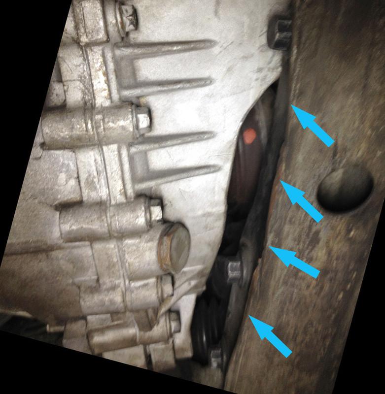

lookforjoe Posted March 22, 2010 Author Report Posted March 22, 2010 To keep it in Star Trek terms this is a very logical mod. P2's even don't have that much space left in that area. I was nervous about doing it, but I was careful not to cut into the webbing, and made sure the transitions are smooth with no cuts/harsh edges that could conceivably lead to stress.. It's probably a non-issue, but I don't want to run into issues with the casing :rolleyes: Quote

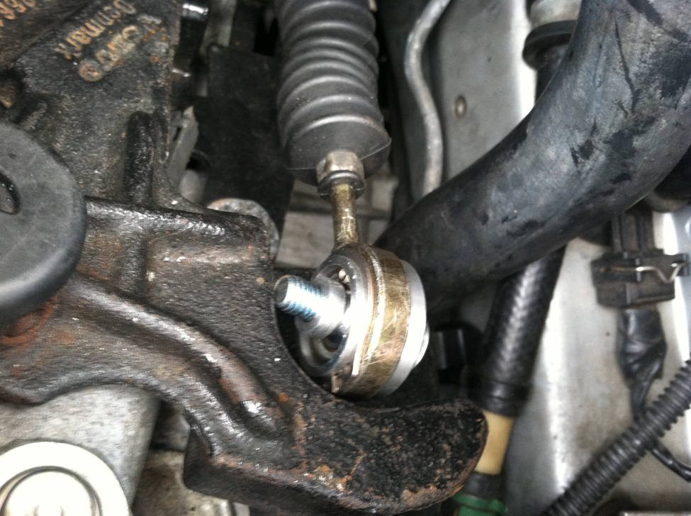

lookforjoe Posted November 7, 2013 Author Report Posted November 7, 2013 Just updating pics of the trans bracket in place Note that anyone doing this on a '00 or AWD with 5 speed auto will also need to buy the '97-'99 style trans mount 9161101 to get the height adjustment. Subframe lugs should also be shaved along the seam Kaplhenke can also supply nice heim joint bushings for the x70 style cable ends (98-00) When filling one of these trans with the modified bracket, easiest to fill through the top shift detent bolt shown in the above pic. Quote
